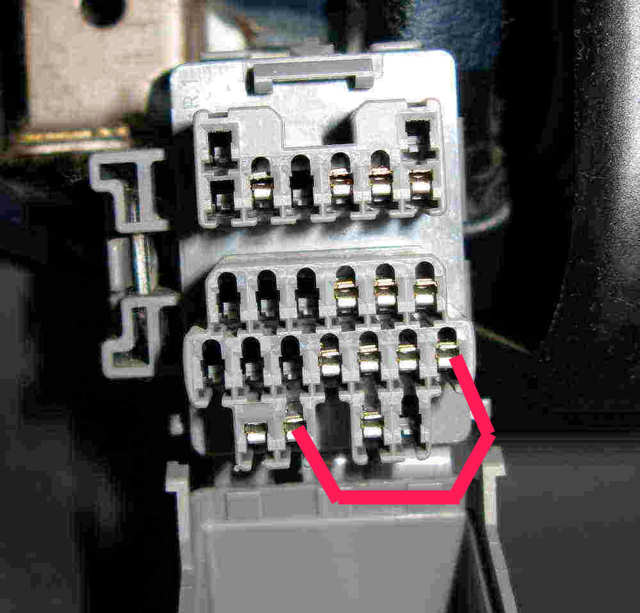

Do you have a picture of the diagnostic socket itself so we can see what pins are fitted ?

Post by Rapidair65 » Sun Sep 06, 2015 12:15 pm
I do have an image but posting pictures on the forum is proving more difficult than fixing the van! Looking at the diagram in the fact sheet the following pins are present :-
Top Row MEN, TEN, +B
Second row GND, FAT, FBS, FAC
Third Row TAT, TBS, Plus next pin.
Fourth row FAB, IG, GND, F/P
I have 11.68v at the +B pin.

Post by Rapidair65 » Sun Sep 06, 2015 12:20 pm
http://s1068.photobucket.com/user/rapid ... g.html?o=0
I don't know if this will work, but here's the link to the photobucket image.

Post by g8dhe » Sun Sep 06, 2015 12:58 pm
Try this connect a link as shown, then watch the Glowplug light on the Dashboard for the code;
The flashing code pattern is described here http://www.philmcfadden.co.uk/MazdaDiagnosticBox.htm

Post by Rapidair65 » Sun Sep 06, 2015 2:08 pm
Geoff, it's a 2 litre petrol.
Already tried that shorting combination. nothing happens. I have an Autel Maxi scan MS309 as recommended in an earlier post about later Bongo diagnostics. I am dubious about the adaptor cable as the pin which connects to the +B terminal is not connected to the socket at the other end. This means that the reader is not getting power. I have ordered a second cable and it should be here early next week. I'm hoping it works but I'm not holding my breath! I had more success trouble shooting Airbus engine systems!!

Post by g8dhe » Sun Sep 06, 2015 2:38 pm
Worth a try, the post 2000 versions would flash the dashboard lights rather than needing to add a LED/Lamp itself, sounds like they had yet another change since then for the version that does work with OBDII and adaptor.
