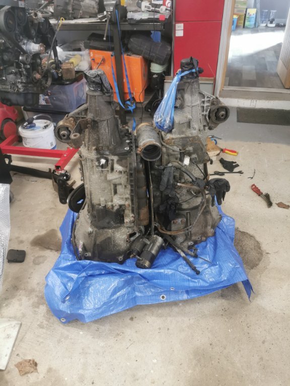

So that's both engines now into the garage, I'm going to get a second engine crane, remove both gearboxes and get them mounted up on stands at a nice working height, quite a few of the ancilleries on the broken engine are on better condition than my donor engine so I'll be chopping and changing parts to give me the best engine possible.

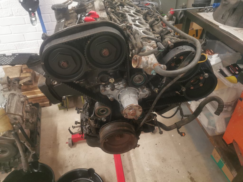

So another little bit has been done, mainly stripping the good engine so I could access the timing belt,
There's oil absolutely everywhere it's going to need a good going over with some brake cleaner and possibly the pressure washer.
I think the timing looks slightly out on the right bank but I'll know for definite when I fit the new belt and it's all clean, it may just be where the pulley sits due the belt teeth.
Everything came apart fine, the lower bolt for the dipstick has been snapped at some point so that'll need sorting but shouldn't be a big issue other than that it just seems to be all seals and cleaning and then choosing the best condition components between the 2 engines to build it back up with.

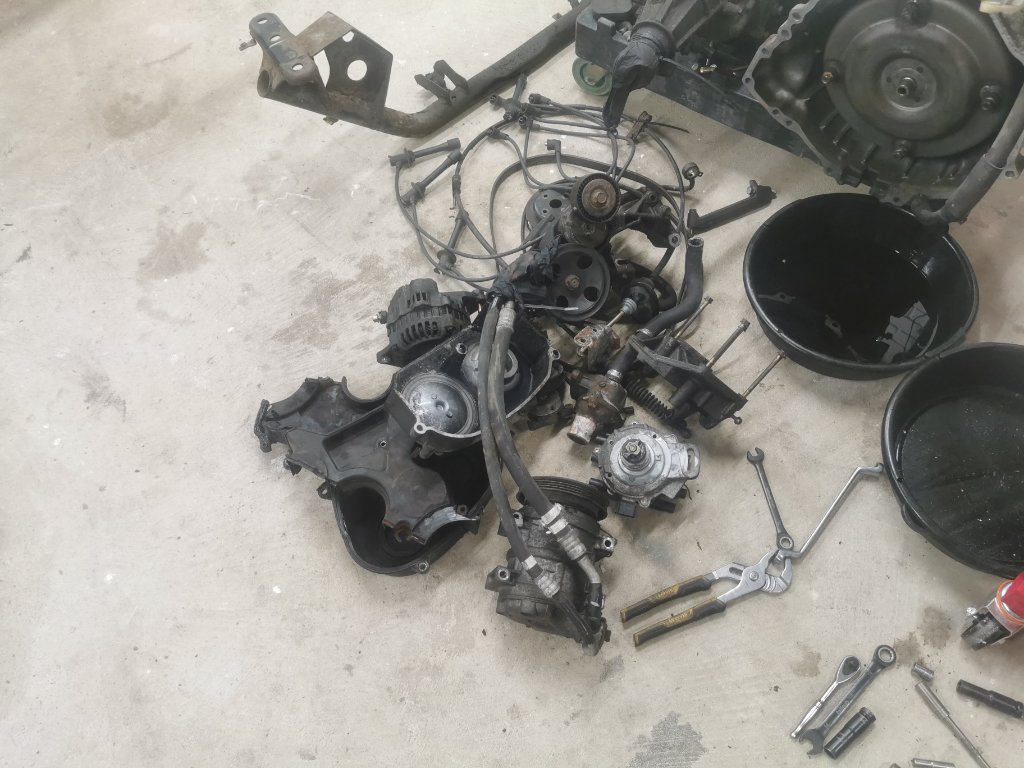

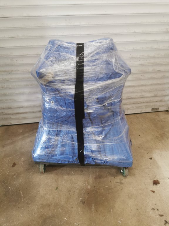

First up I needed to get the gearboxes out of my way as they won't be needed for awhile so I removed the torque converters and put both boxes on a dolly and wrapped them up to keep them weather proof as they will be living outside for a bit.
