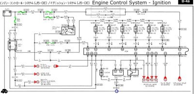

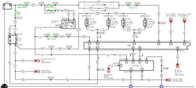

The INJectors circuit feeds several circuits including the engine fuel Injectors. depends on which engine your referring too;
FE-E 2l engine
J5-DE V6
