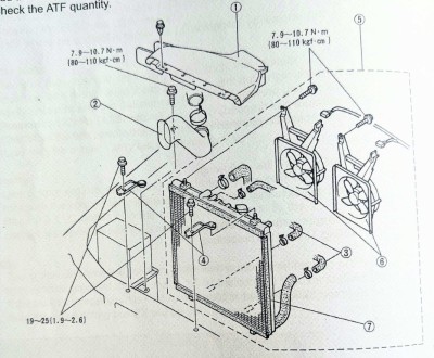

I was under the bonnet of my Bongo at the weekend, and noticed that the radiator is not fastened at the top to the cross-member, also the air scoop is loose.
Hoping someone can advise me what bolts/screws I need in each case.
I've uploaded a few photos:

The air scoop is fixed in place by Scrivits or Screw-Rivets these come in a massive range of sizes I bought a bag of mixed sizes from eBay several years ago and then just select whatever size fits when I need a replacement like these https://www.ebay.co.uk/itm/393601517260
The radiator is not held at the top by any bolts the supports just appear to fit over the plastic caps;

Re. The radiator top mounts, I'll have another look, as it does look like the radiator is sitting too low for the rubber mounts to be doing anything useful; the radiator is free to wiggle forward and back as much as it likes at the moment.
