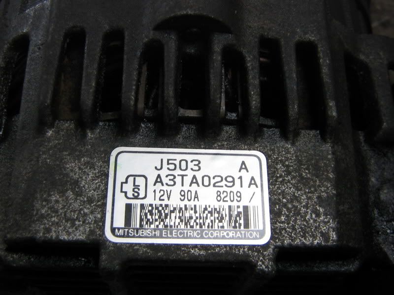

I Googled the A3TAO291A number and it seems that among others, Citroen share the same alternator ... if it could be verified it would be useful, as some are listed as 170+ amps output ..

Just to make sure is this an OEM one that was off the V6? Trying to track one down in the USA
Posts: 2920
Re: V6 alternator
Post by Doone » Tue Jun 24, 2025 8:06 pm
Theres a number on a sticker, on your alternator. You might have to remove the alternator to see it. Then you can match an alternator.
