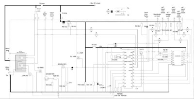

Does anyone have a Wiring diagram for the AFT? Tried using google chrome but still cant get the old wiring diagram site to work.

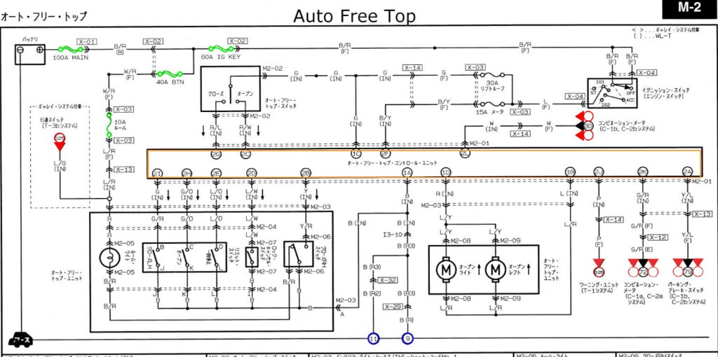

You need UCBrowser currently I'm on version 6.0.1308.1016 but I think a version 7 is available from http://pc.ucweb.com/
as they still handle Flash.
Screen grabs below for you;

Amazing, thank you for the diagram.
Managed to find the problem. There was no power going to the motors when the up/down switch was used. Using the diagram i was able to power the motors direct off another battery at the connector on the AFT control unit. I was able to make the roof move up & down by reversing the polarity so i knew the motors & wiring to the motors was ok. If it powered the roof up with the battery it would go back down off the switch if i pressed the lock cancel button but once i let the switch go it would not go down again until i pressed the lock cancel button again. When the roof was up i sprayed all the microswitches in the runners then worked them in & out. As soon as i moved the rearmost microswitch on the nearside the beeping started as if i had pressed the lock cancel button. After that the roof worked perfectly again. Must just have been a sticky microswitch.

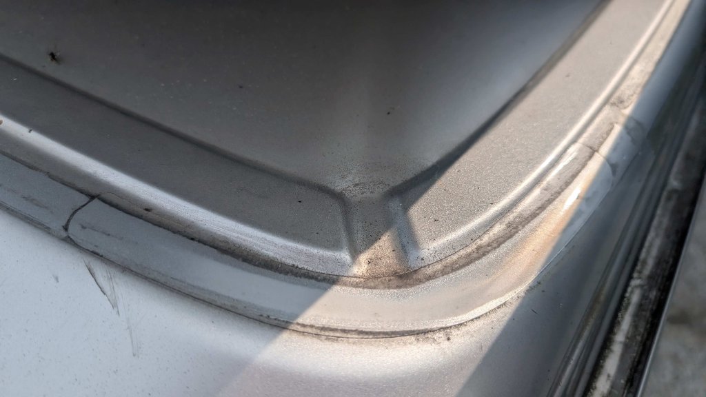

Post by g8dhe » Sat Jun 14, 2025 8:36 pm
Yes it sounds like the motors are stalling due to being unable to raise the roof. Often its down to the rubber seal sticking to the roof, the two front corners are likely areas, there should be plastic pads attached to the roof to stop this happening but sometimes they are missing and the rubber then sticks to the paintwork;
