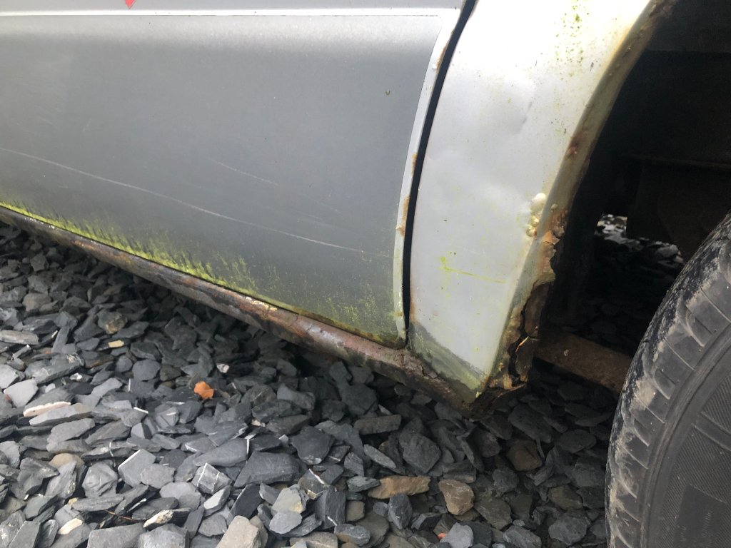

Hi all, I hope you can help with a bit of advice.
Recently I inherited a Mazda Bongo, 1997, petrol* 2.5L engine, 150,000 miles. It’s been sat unused for 2-3 years and after taking it for an MOT the mechanic has found a bunch of issues with it. Some damp has also got into it and some of the interior got a bit mouldy, though I have cleaned most of this up.
Realistically I don’t have the skills/time/inclination to do the repair work, so I’m trying to decide if it is worth paying garage price. The stickiest point is the welding; apparently the sills, wheel arches and an area near the towbar are rotten (I've attached some photos of this). It’ll cost about £2700-£3300 to get it roadworthy again (not just welding cost, see breakdown below), is this worth doing or should I really scrap the van? The interior is fairly decent (fridge, gas cooker, bed, wooden fittings, extending roof) and there is some sentimental value, as it was my Dad’s.
Secondly, if I do go ahead with this, the garage said I might have to source the sills and/or wheel arches myself. Are these readily available online?
Any advice would be appreciated.
*Engine also has LPG, but this is not currently working – mechanic suggested it would be worth getting a specialist to fix though.

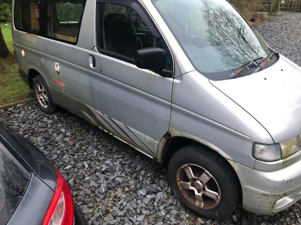

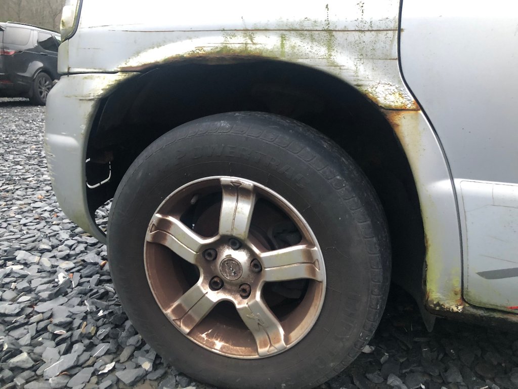

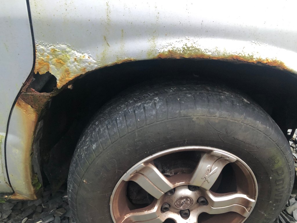

Adding a few more pics...

It’s sadly not possible to say if the cost is worth it to you.
What I would do is caution you against supplying your own parts for a garage to fit. You can see the problem if the parts aren’t exactly right or there’s a warranty issue down the line.
Fitter says the parts were faulty, parts supplier says they were fitted incorrectly.
If you decide to get the work done I would suggest a garage that cab do the whole job, but bear in mind you probably can’t get a final quote until some panels are removed, which if you don’t go ahead it’s Bongo Heaven for your motor.
Hope that helps a little.

Just to clarify, when you say a full quote isn't possible until some panels are removed - is this because the panels might be hiding rust? And if so, which panels do you mean?
Posts: 15465
Re: Repairing rusted Bongo - worth it or not?
Post by Bob » Tue Jan 21, 2025 11:31 pm
Yes, rust may well be hidden, and sadly structural.
Cills, wings…

Looking at this face value, I would be worried. You will have to really know what you are dealing with as the costs can mount, you will be looking at £500.00 of tyres for a start on top of that. (They have shot up in price the last years I noticed)
Check crossmember in the front that hold the air conditionining condenser/radiator for rust look under sills and put 2 latex gloves on and feel all the way along for bad rust or holes. Look under any battery trays under bonnet. Put a high pwoer LED headtorch on and look closely/feel along. Check behind and mud flats or plastic wheel linings and behind the rear arches, basically everywhere ! And don;t be afraid to know the truth, bublled rust can basically be a hole held together with bubbled rust !
You have to fine tooth comb this and you need to be getting some serious use out of it to be worthwhile.
If it is an ATP top (roof tent - auto free top) that is good, a tin top, standard metal roof, they are less valuable generally and that might factor in.
I'll try and check back on this thread as and when you post. Maybe put a few under sill photos, under bonnet photos.
2700/ 3300 and then you need the engine sorting on top ? And the tyres at the very least (they are finished looking at them). + ideally coolant, oil change, oil filter, air filter, spark plugs, a windscreen may be due, is it blurry / scratched or chipped and marked to look out of ? Add £350.00
Are all the electrics working ? Windows, lights, aircon, wiper motors, internal fans, side door motor, the auto gearbox, power steering, brake pads/disc, they will all need the fluids checked/topped up changed as well really. Look at the exhaust for rust as well.
Can you get a LPG person to asssess the engine to work out a cost for that before you go further. Might be worth the cost for their opinion/quote ?
There is much to know about and it will factor in as to whether you bother I think.
