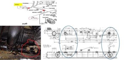

Having now replaced the g/box oil cooler pipes and the flexi rubber pipes either end, I now find that there is a serious leak from the connector where the flexi rubber pipe connects to the cooler under the radiator. from my limited ability to crawl under the van it seems that there is an elbow which screws (?) into the oil cooler which is badly corroded.
Does anyone know if these connectors can be replaced otherwise it means a complete new radiator which does seem a little excessive given the cost and hassle.

This reply from Shanil at Warrington Mazda after an enquiry to Belgium/Japan:
The connecting pipes are not serviced separately.
This was the message I got back from Japan, unfortunately the connectors are part of the radiator rrp : £306.89 +vat
delivery eta 3-5days The pipes are included in D-code 15-200 (radiator).
My plan now is to fit a universal oil cooler as the main rad is in good nick.

Re: Rotten Gearbox oil cooler pipes - HELP!!
I'd seal those two pipes up too.
