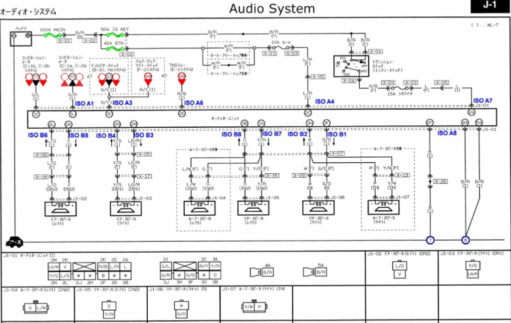

Radios actually have TWO 12v supplies!
The first is an un-switched supply and is to retain memories and settings, this is NOT affected by the ignition switch, this circuit feeds several items (door locks internal lights etc) the wire colour in the original Mazda loom is Blue/Red and is on the Mazda plug at 2C position, if you have an ISO adaptor fitted then that becomes pin ISO A4.
The second supply is for the main radio operation and is on the Ancillaries Circuit, first position on ignition switch, in the Mazda loom its a Blue wire and the Mazda plug is 2A which via an ISO adaptor appears on ISO A7.
Its not uncommon for people who install new radios to be unaware of this and hence connect the supplies incorrectly either both together or they forget/misunderstand the need for the un-switched supply - hence the reboot as all power is switched off!

That sounds like the backup supply is not present at all, that supply is fed directly from the battery not via the ignition switch, its the only the main power that is fed via the ignition switch. The two power feeds are at the top right as you can see one is direct to the battery and the other via the ignition switch.

That is correct if you left the ACC powered up the then the switching spikes from the starter motor stand a good chance of doing damage to any electronics which are not specifically designed. The very low current backup supply, the ECU all have additional spike protection, most other circuits are also disconnected during cranking of the starter motor for the same reason.
However the Radio should only just be turned off, not re-booted where you loose the memory settings etc. which is why is sounds like the backup supply isn't connected, loosing the backup supply is what causes a re-boot as opposed to a simple turn off.
