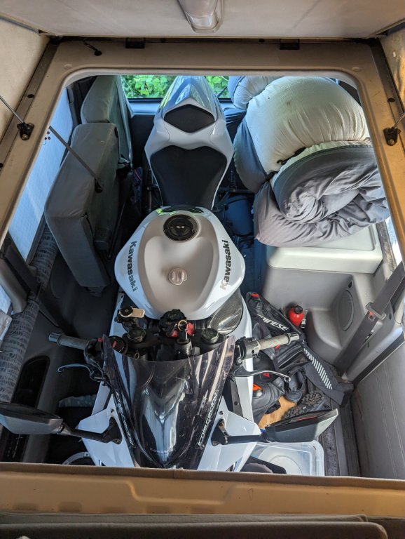

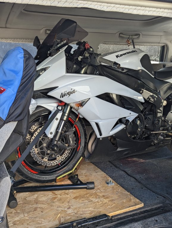

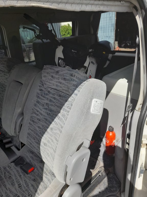

Will fit a full size bike with rear bench removed or a smaller monkey bike/grom size bike as is.
Would recommend mounting a chock to a sheet of plywood if you're planning on carrying a full size bike as it will be much more secure and also make loading faster and easier

I’ve been meaning to measure the rear door opening but your pics clearly show it’s big enough.
Is it two different bikes in those photos.? (Can’t tell on my small screen).
Did you need to do anything to the bike other than remove / fold down the mirrors.?

Yea that's two different bikes in the pictures. The small one is a Benelli tnt 125 - basically the size of a new monkey bike.
You might struggle a bit on height depending on what kind of bike you want to put in there. A V-Strom would be a fairly tall bike so I'm not sure you'd get away with that but the other bikes you mentioned would probably fit in there without too much trouble.
