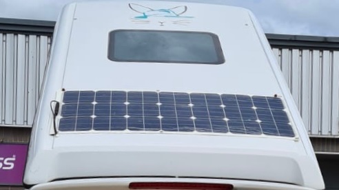

Some advice please. Our 2001 Bongo has a solar panel and controller as per these pics. This is the only system that is keeping the leisure battery topped up, apart from the split charge systemwhen on the road. The controller was reading 14.2v before leaving for France last week. Now it's blank. Does this mean the LB has been drained completely or is there a button that needs pressing somewhere I haven't yet discovered. The lift-out 12v fridge is the only thing in constant use. Many thanks in advance from a newbie! Peter

Latest update on our solar charging system. I've put my multimeter across various terminals with the following results.
In full overhead sun with wires disconnected at the PWM controller, meter set to 200v - output 25volts with a reading of 2.61 amps. I'm guessing this means the panel is ok.
The PV-XC502 panel terminal block contains two diodes mounted inline, connected to each of the outer terminals and also to a central terminal. Readings as follows - between plus and centre terminals +12.35v; between minus and centre terminals -12.73v

Sorry to jump on your post but do you know the make/model and output of your solar panel? My van is currently at the storage location so I can't measure teh roof and it looks like yours is the widest that will fit so a good start point.
