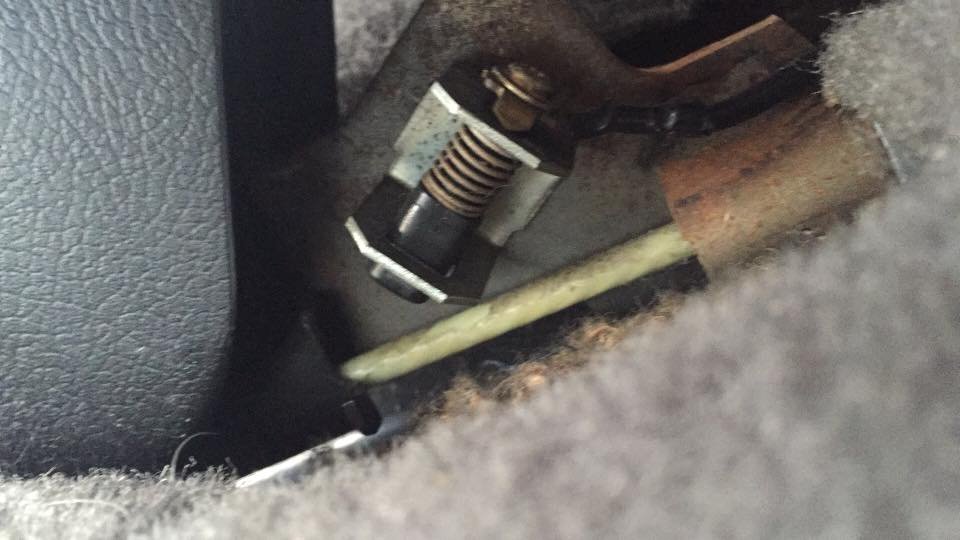

Hiya guys I'm facing same issue when working on my starter motor ( long story ) I thought it may of been the wire connectors stopping me from starting Van-Diresel up, but looks like it's the start of a solanoid issue, upon checking I noticed I didn't need the foot break to take it out of Park so I tested the handbrake and lost the hand break switch, the spring propelled it somewhere and I'm still looking for it. Can someone please point me to where I can I can get a replacement switch? I'm only finding footbreak switches. In the meantimey AFT won't go up until I put the ground wire from the switch directly on the metal.

The switch is fabricated from bits, its not a standard part, best bet would be to visit a breakers and retrieve the spring and plastic parts and then re-assemble them on yours.

The best photo of the Brake switch I have is this one;
The screw upper right has the brake signal wire connected to it before it passes down into the plastic block, with spring, when the brake is pulled on it earths the signal wire to light the lamp and signal to the AFT computer that the handbrake is operated.
