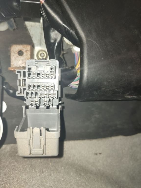

Hi All, also getting hold light issues. Garage replaced entire gearbox, which has fixed the issue of the vehicle sticking in gear or refusing to move out of gear.
But light is back, garage happy to help but are claiming that there is no diagnostic error. I have got myself an obd scanner with the standard end and used that, and sure enough, no errors. But then I found another port that has a clip on the front that says 'Diagnostics' and has 25 pins, I have spent a good hour googling but can not find an adapter that matches the port - any ideas what adapter I need to access this port? Thanks in advance and apologies if this has been answered elsewhere, i did do a big search through other posts and couldnt see it asked anywhere

The box in the image is the older OBD diagnostic box, it is NOT OBDII (OBD 2) compatible. I've never found a convertor, although some high end garage quality devices have both interfaces.
You haven't said what year or engine you have? Some very late versions had an OBDII connector as well in the normal one placed to the left of the steering wheel under the dashboard edge, that will report the standard OBDII P???? error codes.
If the Hold or Glowplug light isn't flashing then there won't be an error code stored, the error codes are also lost when the Ignition is turned off.
