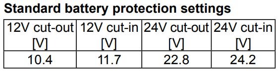

Thanks Geoff. I'd never have guessed it was possible to connect my fridge to a laptop by usb!
What's a sensible cut off to avoid damaging a leisure battery (standard lead, not lithium)?

Post by g8dhe » Thu Jul 21, 2022 10:45 am
I would leave it at the default settings unless you have special reasons to change it.
