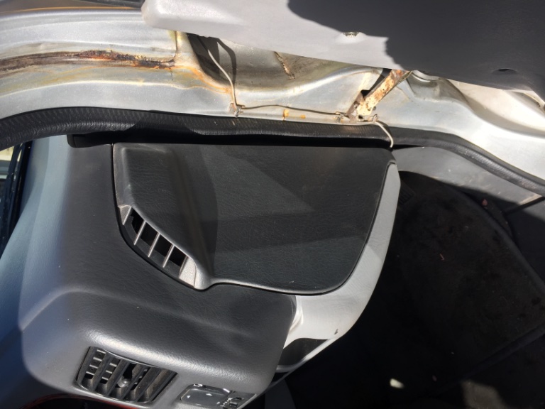

Hi Geoff, yes I think it’s definitely an electric issue. I’ve posted about the speedo and rev meter previously and you suggested checking earthing point 7. I can’t seem to find a way in to the location - see attached. Do I just pull out the plastic at the end? It seems quite well attached and I don’t want to break it!

Yes that's the panel, its been along time since I had mine off and can't remember the precise actions to get it off now!
Yes no screws shown in the diagrams as below parts 64-911B & 64-911X on the diagram below;

You might check underneath the dashboard but as I recall its very crowded area to see what's what, the wiring will certainly come in from underneath but I can't recall the exact positions of the earth tags.

The thin black wires? They just go up into the door frame and are attached to a mini speaker-type thing that I presume was part of a previous owner’s hands-free kit.

Ah OK, in the Mazda wiring looms Black are earth/chassis connections hence seeing the Black wires makes me look for the multi-earth connector that is usually used.
