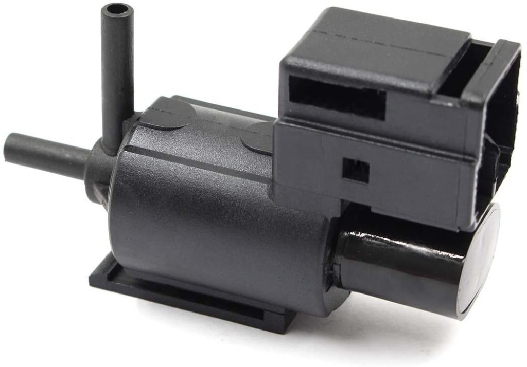

It isn't actually the PRC the fault points to, it's a little three port solenoid at the back between the two banks - two vacuum pipes, a vent to atomosphere via a filter and a 12v supply, the ground side controlled by the ECU.
All the testing per manual comes back OK, as far as ECU pin 4J. Said solenoid takes its signal (apparently) from the coolant temp ≥90°C and the engine bay temperature ≥50°C.
I guess the next step is to find and test the engine bay sensor, although I would have expected that to throw up a fault code?

This little beastie
Posts: 10884
Re: V6 Fault code
Post by g8dhe » Mon Jan 03, 2022 11:03 pm
Ah we may be looking at different things here!
See here http://www.lushprojects.com/bongopartsm ... 1of03.html
18-741C (no.1) top right is a vacuum solenoid valve which is what your pointing out, which is part of the EGR system.
Whilst I'm looking at 13-280A top right here http://www.lushprojects.com/bongopartsm ... mgno=.html which is the Petrol Regulator Control valve and controls the flow of fuel.
The vacuum valves are well known for failing usually the plastic tubes crack or the piping around them they are easily available on eBay I believe https://www.ebay.co.uk/sch/i.html?_from ... 1&_sacat=0

Getting there then, Geoff! I did wonder how it would throw a code up. However, the manual refers to it as the PRC solenoid, not EGR.
I'll have the centre off today then and check the pipework, pain in the backside - there's two of the buggers and both test OK. I'll have a look at the engine bay temp sensor too.

There are indeed two - but only one test procedure for the vacuum path, so I assume thats for both... May try swapping them over. The centre (more forward one) energises on ign on, the rear one is the one controlled by the ECU pin 4J. I'll check all the hoses, but a cursory glance yesterday didn't make me think they would be bad, and certainly the hose stubs are sound.
