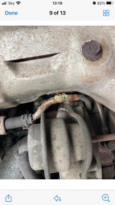

I've been taking a few more pics and found what looks like a suspicious leak however, not sure if it's related - does anyone recognise this one on the passenger side?
Any ideas where I could source a replacement head if needed?

Trapped air will lead to overheating and cracked cylinder head. :(
If you're having a garage do the work it's often best to have them source any parts required, that way if there should be a problem you can take it back.
It's not unheard of when an owner supplies parts and things go wrong the garage will blame the parts and the part supplier says they were fitted incorrectly.
