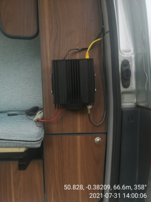

Funny thread now
I dont have a perm setup in my Bongo yet for a radio. Will investigate over the winter.
Here is the video of operation from the New Forest from the Bongo !
Was great fun to get away from the interference of the home.
https://youtu.be/MKd5ZWDUz-E
I'll have to search the forum for any tips on setting up a radio in a bongo for grounding - i was going to try a plate to the roof but decided against that in the end. Have tried a gutter mount with some sucssess, but was only measuring S.W.R. readings - whats the capacitance and resonance of a mazda bongo hahah
I'd be interested in swapping out the antenna on the side with a 2m/70 type of whip - any of my fellow hams done that ?
