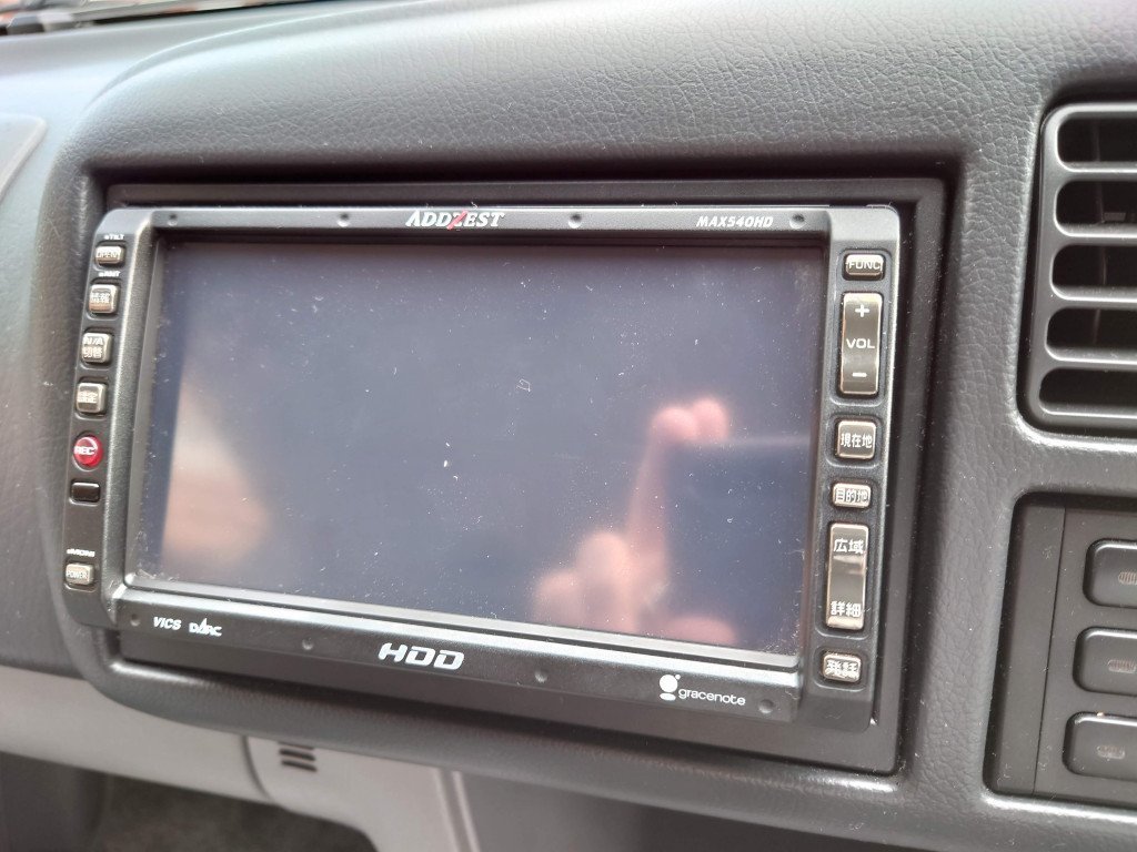

I have a dilemma which I hope someone can advise on... I've had my Bongo a couple of months and now 'need' to replace the Japanese 2 DIN stereo whcih is in there. Menus are all Japanese and the HDD has Japanese MP3 music on it...nice but not really my musical bag. The CD and memrory stick doesn't work.

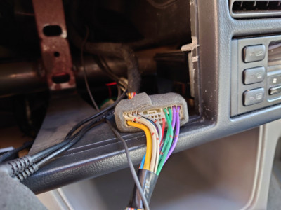

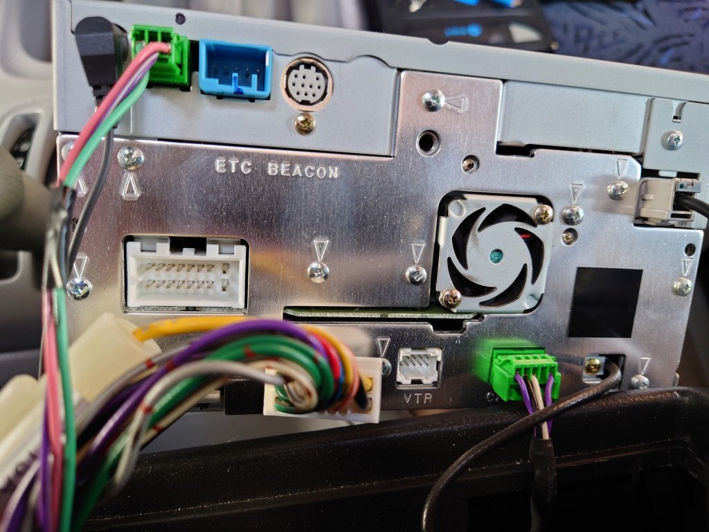

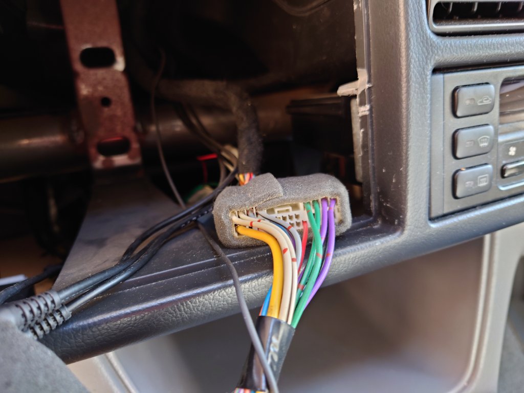

So, I've succesfully removed it to find that there isn't the connector which I can use the Bongo ISO harness for. The main connector (see photos) is a Clarion 8 pin thing which I searched everwhere for an ISO harness for, with no luck.
I can't even wire my own harness as I need an appropriate plug, which I can't find.
Has any other Bongo owner faced this and resolved it...or do you think I'm stuck with what I have? :-(

Keep digging back on the cables you will eventually reach the original Mazda loom (wrapped in foam) then depending on the age of your vehicle one of these two adaptors will connect to the ISO standard;
There are two types of adaptor depending on year;
from 1995 to around 2000/2001 it is PC2-10-4,
after 2000/2001 it becomes a PC2-78-4
both types are available on ebay,
https://www.ebay.co.uk/sch/i.html?_nkw=+PC2-10-4
https://www.ebay.co.uk/sch/i.html?_nkw=+PC2-78-4

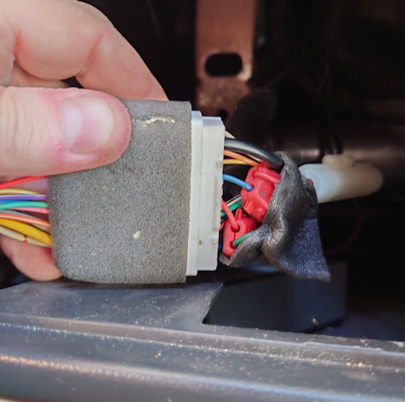

I think this is how you described it isn't? So does the adapter that I'll buy plug straight into where the wires currently are, or does that white adapter come apart?
So sorry for the basic questions :-(
Thanks again for your guidance.
Posts: 10919
Re: 2 DIN Drama :-(
Post by g8dhe » Tue Aug 10, 2021 7:50 pm
Yes buy the adaptor, then the other part comes out that goes to the old radio, the new adaptor plugs in in its place and will have the ISO plugs on it.
