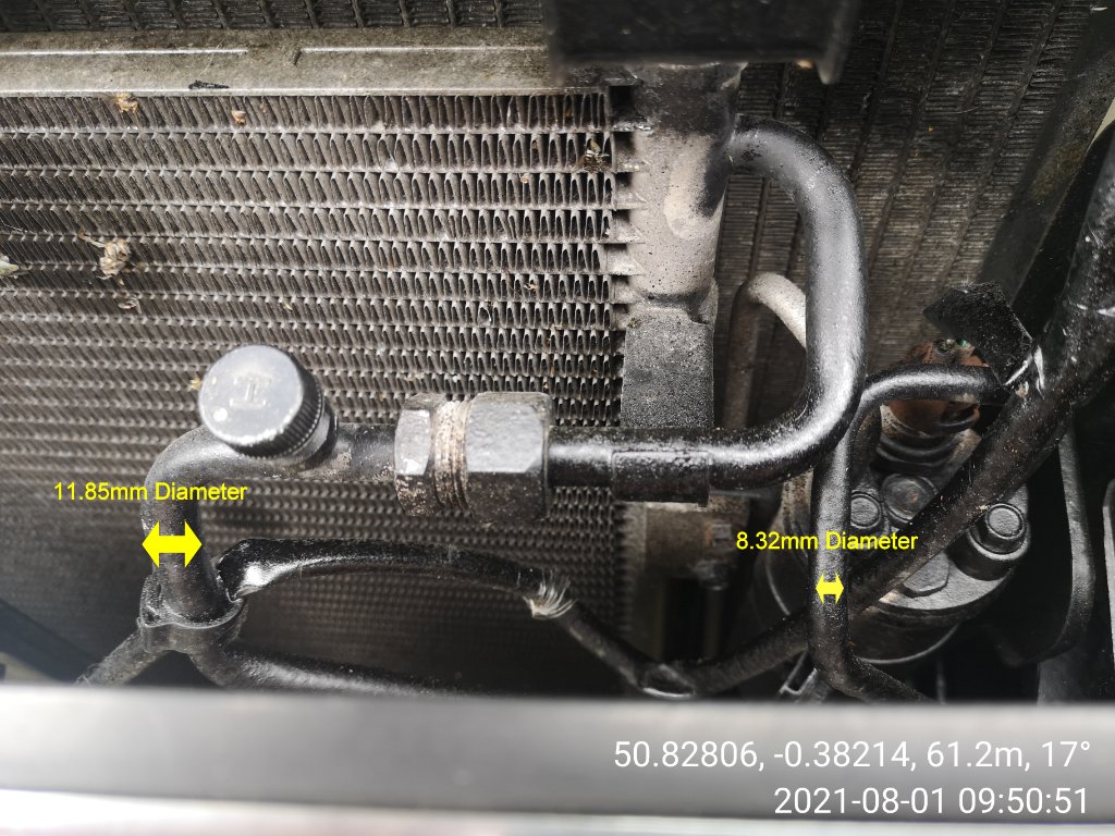

Yes that's why I'm thinking mine might be only 750g + 50pag as its December 2001 off the production line, it would just be nice to make an easy measure of one of the pipes that are easy to reach and know for sure. Infact I will do that now and post my measurements and see if anyone can do similar for a pre-1999 model and we can see if we can find an easy way of making the decision!

Right here we go this is for;
Body number SG5W-500904 Date of issue 12/21/2001
So that is 11.85mm outside diameter for the pipe feeding the "H" high pressure fill valve.
The pipe from the top of the drier tank is 8.32mm outside diameter.

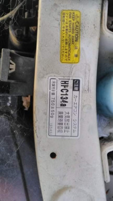

Sometimes there's a plate that shows the amounts needed. It's usually on the the slam panel by the passenger side headlight or on the bonnet by the battery stickers. Unfortunately it's not on all Bongos! Here's an old photo of one.

Thanks Doone, yes I've had a cursory look for a label nothing visible but to be fair its usually when I've been doing some additional wiring, so may have a more detailed check in a bit. It looks like who ever did the undersealing also decided to spray a lot of bits under the bonnet as a lot of the pipes etc are covered in the black layer which is a little annoying!
