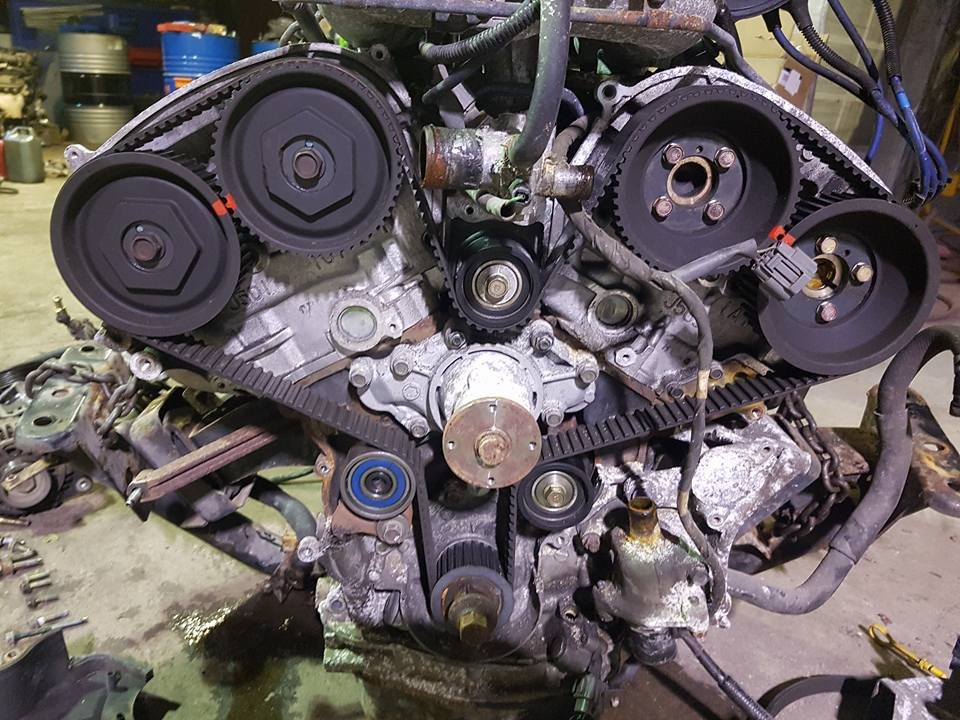

I guess it's a quick undertray off, clean up, and see what happens. I'm loath to bugger about too much as it only had the crank seal and cambelt changed a couple of years ago (before we bought it). That picture is incredibly helpful - do you know if the pink timing marks are Mazda or garage?
I was a little worried after your FB post about clearances in the manual - these are things that can't be guessed, realistically ditto belt tension.

And those sprockets look dowelled on the cams, which is excellent news.
