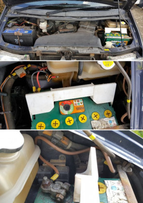

Under the bonnet I can see the second battery is wired up and earthed;

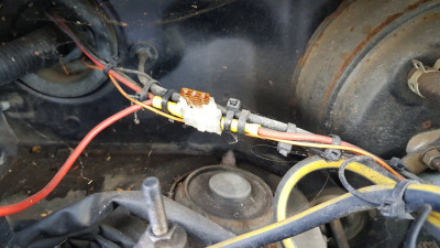

From what I can see the wiring is fused and runs along a pipe to the fuse box;
Then as far as I can see it then goes through the bulkhead into the vehicle;
Could it be the two batteries are running in parallel?

That certainly looks like a leisure battery set up, not the second starter fitted with the 'cold start' pack. For interest the switch operates a valve in the exhaust system, it doesn't control the battery.
If the last owner never used it the battery may be beyond recovery. You can do a basic check with a multi-meter, or any accessory shop will have a test meter so I'd check that first.

Thanks Geoff. I have just carefully tracked back from the LB and I can't see it goes through anything. In fact I said in my original post that it went into the fusebox but I don't think it does. It seems to go from right to left and meets up with the cables from the starter battery (pictured below) and then goes through the bulkhead;
Assuming that is what happens can you suggest what that is supposed to achieve? Would the two batteries be running in parallel?
Thanks for your comment about the grade of wiring. I suspect I will be having this rewired by someone qualified so they will no doubt use the correct grade. But first things first I will test the LB to see if it is dead or alive.

Some installations put the SCR in the cabin itself, not under the bonnet which is not a good move as it increases the wiring length a LOT! You will probably have to track it thru the bulkhead and find out where the feed goes.

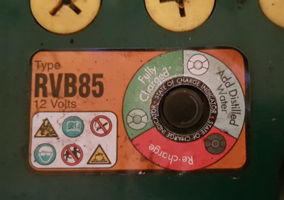

Firstly, the leisure battery only measures about 6v so clearly is not charged/healthy. He thought it was worth trying to charge it so I took it out tonight and according to the indicator on the top of the battery it needs charging rather than water adding;
So I connected it to our Halfords battery charger and it said it was charging it for 10 or 15 seconds and then the light indicated that it was charged ("Ready and Maintaining"). As it's an old style battery which can be topped up with distilled water and I had most of a bottle of Halfords "Battery Top-Up Water" to hand I opened up the 6 'vents' on the top and topped up 4 before running out of water on the last 2. I connected it to the charger and it seemed to charge for a little longer before the charged light came on. I'll get some more top-up water and try again but it's probably a goner isn't it?

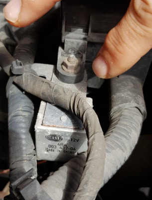

Also, the leisure battery seems to go through this box;
It's some sort of a relay - could this be a split charge relay? It seems to be a Hella 12v 4RA 003 437-04. I can't find much about it online and what I can find doesn't mean much to me (eg https://www.wantitall.co.za/industrial/ ... b07dh2rq4g). Or maybe it is totally unrelated :-?

I think I would be changing that battery, if its been left without water /electrolyte in for a period the lead surface will be damaged and it might take a charge but the capacity will be way down as only half the plate area will be working properly.
Yes that relay is almost certainly the one doing the Split Charge function, its plenty adequate for the role as its rated to 60 Amps. It will probably be either Ignition switched or being fed from the Alternator check lamp (not a good choice of circuit).
