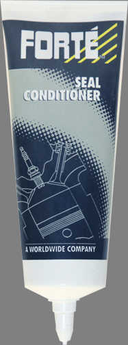

I used some additive to the oil for a good 6 months until the cam belt needed doing to avoid the extra costs it seemed to work OK.

Geoff - you called it lol! Small leak on drivers side . . . . can you remember how much it was to get repaired? With the Forte Seal additive, is it as simple as adding the tube to the oil tank or does it need additional work?
8) V6
Posts: 10693
Re: V6 aircon burny smell
Post by g8dhe » Tue Apr 06, 2021 8:25 pm
I used the Forte seal for quite a while, just simply add it into the engine oil, under the drivers side seat. I waited until the cambelt needed doing and then had the belt, and all the seals replaced, as most of the cost is in getting to the front of the engine, as I say the parts are cheap! I think it was around £600 at the time several years ago now, also consider the water pump being replaced whilst at the front and make sure that the oil isn't getting into the alternator and blocking the ventilation ducts up as otherwise you will replacing the alternator as well when it blows its diode pack from overheating.

Probably, I never noticed anything visually on mine from above, but could just see it around the exhaust manifold and more importantly I could see the smoke/smell that was being generated when the passenger seat was up. Started using the additive and kept on adding it for quite a while I can't remember how long, until the timing belt was getting close to its renewal date, then had them done. The alternator failed quite a bit later on, but when inspected it was full of congealed oil hence the overheating and death of the diode pack.
