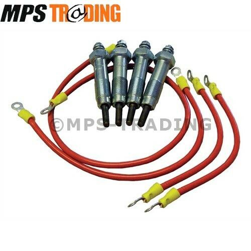

Due to not being able to find any known brands I have thought about fitting the shorter (83mm) NGK Y-701J plugs but rather than modifying the fuel rail (bending it out of the way) I was thinking of using wither M4 20-25mm Standoffs (screwed onto the glow plugs) to extend the height for the bus bar or making up insulated link wires with ring terminals to connect to all the plugs, has anyone tried any of the above & had any success or issues?

Here is a pic of a standoff & something similar for the link wires to give you an idea...
