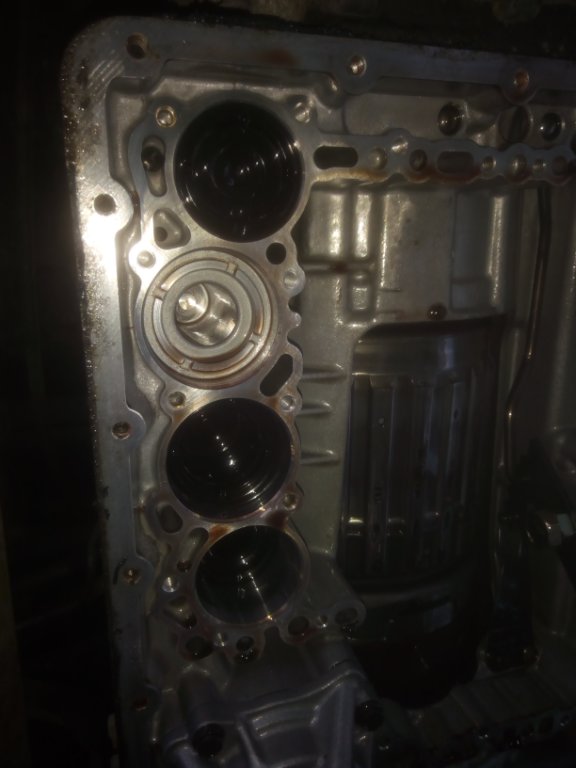

1. In lowering the valve body (replacing solenoid pack) I failed to note (late in the day and lowering from the drivers side) the order of the accumulator springs. One largest and fatter than the other 2 which are of a similar length but one slightly larger diameter. I am assuming! that the largest at front and the other 2 in size order (larger smaller) at the rear. However, there are 4 accumulator "ports" from front to back and number 3 does not appear to have anything in it. So, 3 springs, 4 ports. Has anybody any idea/experience of the this?
PS nothing "sprang" out or fell off during lowering.....these are the parts/springs which I have.

Ok...after further research using the lushprojects diagrams I reckon that pot 4 (from the front) has no accumulator spring as it has an internal spring.
That means 3 pots 3 springs. Pot 2 appears to have a larger spring leaving me to choose between the 2 smaller springs. 50/50?

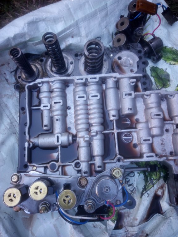

Problem solved. I realised, after 24 hours of forums and research, that I do have a brain. The springs are designed to fit the pot! there is no way of going wrong even if they fall out while you are lowering the valve body. See attached photo. The actuator at the left of the springs has a spring behind the piston in the valve body.

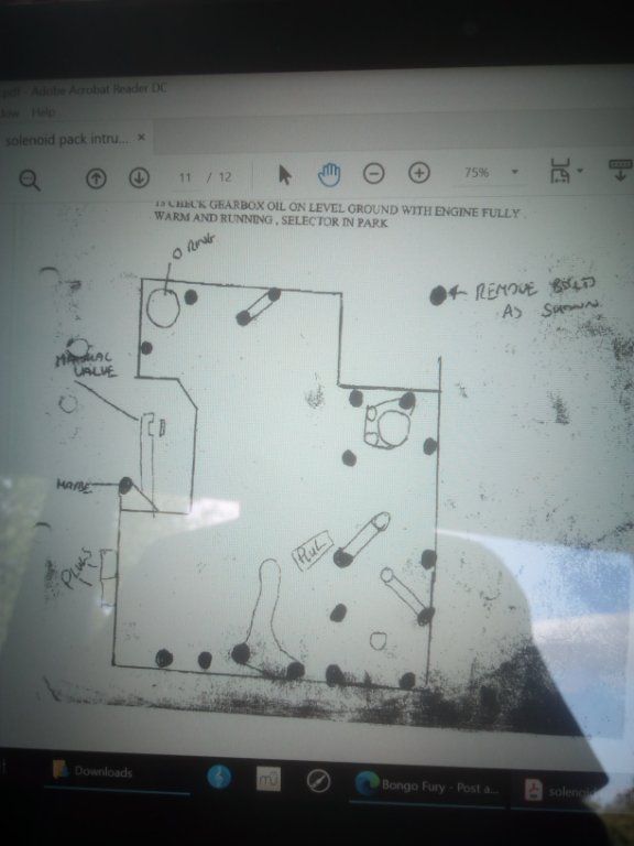

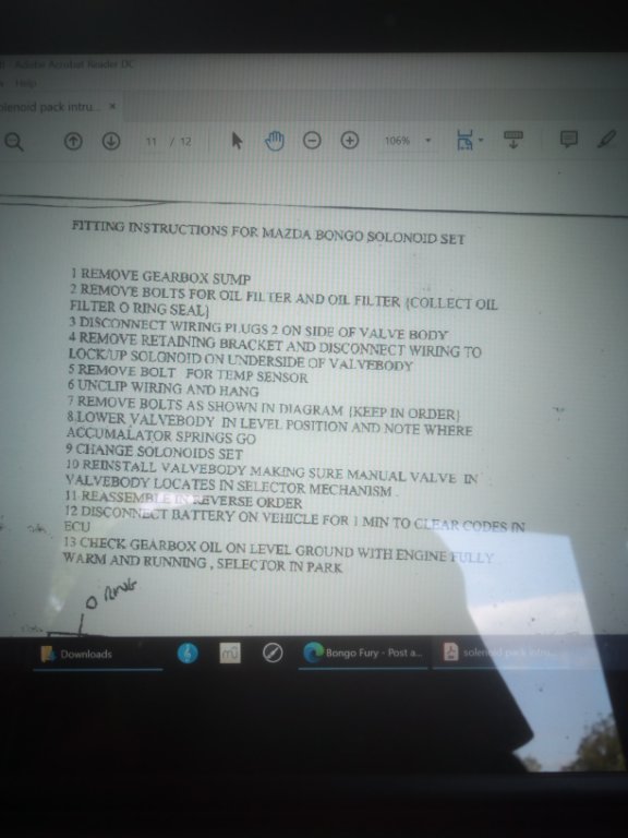

Here are the original instructions sent with the solenoid pack.
To sumarise. Fitting a solenoid pack is not that difficult. I used a pump to remove old ATF. A jack for the sump and the valve body. Everything is 10mm. And best of all my Bongo works great!!
