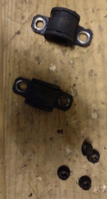

Well that was easy enough in the end, all four nuts removed easily.
Is it standard procedure to reuse the old nuts. They look ok.

Rear ARB bushes now replaced, that ended up being a lovely easy job.

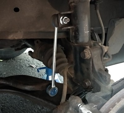

I've replaced one of the drop links. That was a pain in the backside!
The bottom nut came off with a lot of effort, but the top one wouldn't budge. It came out a bit but then jammed up. After a lot of effort trying, I ended up cutting it off with a junior hacksaw. New heavy duty one took second to put in its place. By this time it had gone dark and it was raining so I left the other side for now.
The Heavy Duty replacements feel to be good quality but they don't look much more durable if I'm honest. Differences are quite subtle, between the one I took off and the new one. It used a 16mm spanner to hold the flats, compared to a 14mm on the old one. Both used an 18mm for the nut, which is really annoying as my decent set of sockets doesn't have a deep 18mm socket, and the thread gets in the way of using a regular 18mm socket.

The driver's side was a lot easier to do, both nuts came off no hassle at all.
The only difficulty I had was lining up the new one. The old one was hard to get out and then the new one was even harder to get in. I had to put the wheel back on and lower it to the ground, then get some to stand on the drivers step to get it to the right place to go in. The first side was really easy. Is it just a case of how it was all sitting? Anything I should worry about?
Out of interest the driver's side one was a HD one already. Will have to try and work out when that one was last replaced. I have a feeling 2016 but will need to check, maybe that was why it had been laying better than the passenger side.

All passed and back on the road again. Still got a slight knocking from the front end. The new drop links have improved it but it hasn't gone altogether. I will try the front ARB bushes at some point. I don't think it is the strut top bearing as was suggested because it doesn't make the noise when turning and the videos I've watched don't match with the noise. I am running out of other possibilities though.
