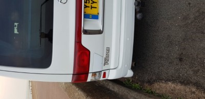

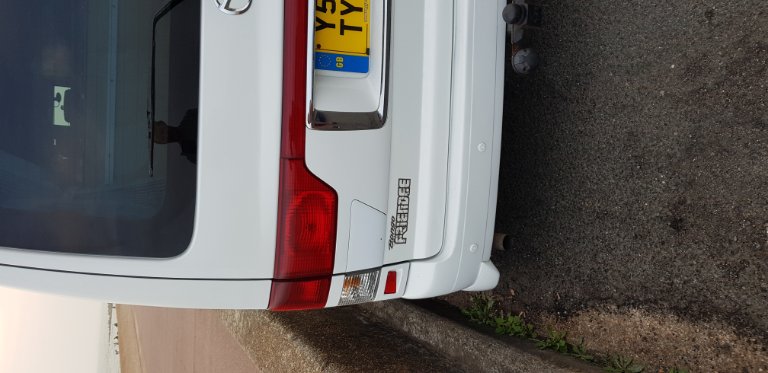

Roy748
Posts: 337
Location: Kent
Re: Rear Lights - Rear Door
Post by Roy748 » Sat Aug 15, 2020 7:28 pm
Having applied the same approach in that I too drilled two small holes in an attempt to clean out the reflectors but to no avail, I ended up buying some white (as my van is white) self adhesive vinyl and covered them so now they blend into the body of the van.
Self adhesive vinyl covering
