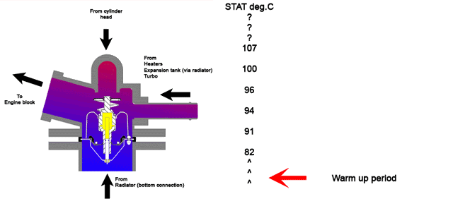

Surely you expect the pipe from the radiator to be cold ? Its the cross flow over the top of the thermostat that is the flow to be cooled down ? Click the image for animation ....
http://www.g8dhe.net/bongo_images/widdo ... ration.gif
