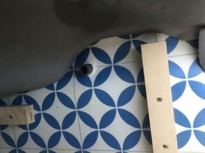

Both Bongo’s full side conversion, first it was at the back not far from boot already done when I bough it, sealed into locker itself.
Second I’ve removed rear heater matrix so just used one of the nice holes Mazda made for me to run from inside locker outside the vehicle

It depends on where you intend to put the bottle locker. Just check underneath first. I used a soffit board vent with a mesh cover and cut the hole with a 32mm hole cutter and strapped the bottle over it.Mine was at the rear offside.
