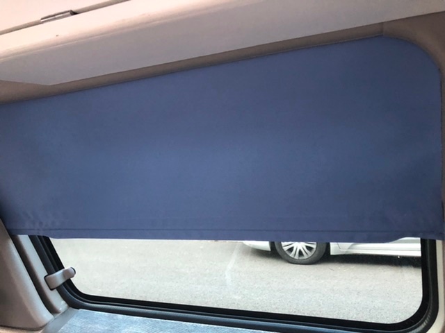

cwilliams255
Posts: 124
Location: Sheffield
Re: Bongo blind pattern template
Post by cwilliams255 » Thu Jul 30, 2020 7:51 pm
I used the old ones for templates and a couple of dunelm blackouts to do this. Cutting the edges and avoiding any fraying was probably the hardest bit. Way better than the originals though (although I have to admit their sewing is marginally better :D ) and have followed me to my 2nd bongo too
