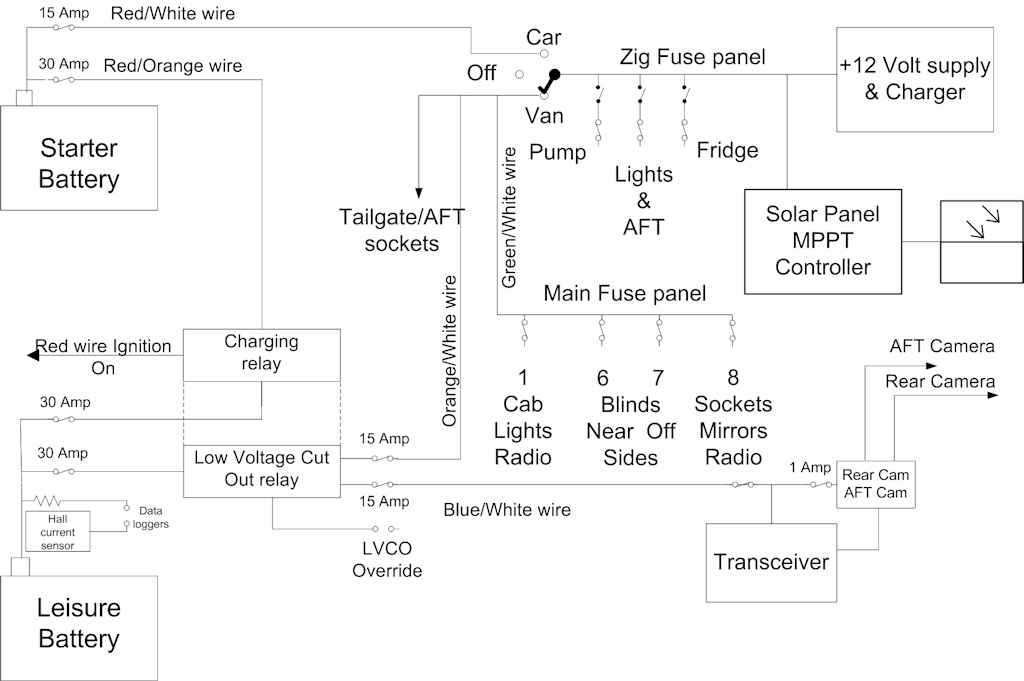

This is a reasonable quality power supply https://www.ebay.co.uk/itm/Caravan-Main ... 1671538733
Zig Marque 1 on eBay https://www.ebay.co.uk/itm/Zig-Marque-1 ... SwVqpelVzJ There are all some other look a like panels around as well.
Mine is connected thru a ZIG marque 1 panel which has a voltage display and in parallel with a solar system.
