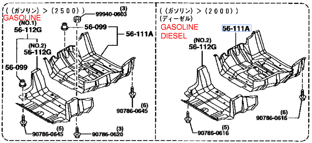

Hi Guys, I ordered the engine trays from a breakers up north and they arrived today but only 2 I've had a look at the diagram and can see that the parts are 56-113, 56-112 and 56-111. I have the last 2 but not the forwardmost one of them 56-113. Just wondering if there are three or are there some that only have 1 and others that have 2. the diagram oddly shows two trays in an additional box with the front one showing separately I'm a bit confused as I have none so don't know what the right number should be. The breaker has a Bongo there but says that one also only has two. Any help, as always guys please...

Which engine version is your vehicle ?
They all have the front section 56-113
and the versions are as below;

Hi Geoff, I've had delivered the 112 and 111 but not the small front one which i think is 113 so you're saying that all variants should have the front one which is the one I've got missing. Thanks for that, i'll get back to the breaker to see if he has that one as well. if they are as has already been discussed to do with heat direction as well as road noise reduction then I guess all three will play their part

Which year is your vehicle, the diagrams only cover upto 2001 so its possible that later versions might not have had it, as I notice that in the 2001 year they had dropped the Splash Shields 56-942C on either side ?
Edit: Ah no they moved them to a seperate diagram!

For info, only two fitted on my 2002 petrol 2.0ltr.

It's a 1996 2.5 TD 4WD. It does look as though there are three two under the engine and scavenger fan and another from the front bumper going backwards to protect the rad and intercooler. The breaker guy is having a look round. the one he took them off of I assume has gone to the big Bongo in the sky but he did originally say that there were three trays.
