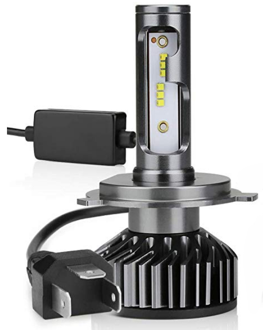

These are the bulbs I've been looking at ;
https://www.amazon.co.uk/JamieWIN-12000 ... 282&sr=8-4
They are about £30 , there are others on there for £40-50 . I don't mind the cost as much as the quality and quantity of light . I'll be using the bus a lot for the next few months in the dark hours so I'd like to get a good bulb set up once and for all .

Re: Led h4 head lights for the bongo
Which make/model/style of lamps are you currently using ?
The H4 light has two sections;
The low beam which has a sub-reflector behind it and only illuminates the upper half of the main reflector, thus the light shines downwards.
The main beam illuminates all around the main reflector so the lower half is what sends the beam out further forwards, beyond the low beam area.
See here for diagrams from Bosch https://ratwell.com/technical/BoschH4.html#vs
Now the LED lamp you link to appears to have what looks like a normal beam pattern for low beam as it only radiates upwards, from the front most section;
but the 3 LED's towards the rear also only radiate upwards, there are no LED's radiating to the sides or "behind" so its unclear to me how it can use the entire main reflector ?
Another factor is being fan cooled, you may have problems attaching the rubber waterproofing flap that covers the connector which is on a cable tail hanging down swaying in the breeze.....
However without a much closer examination of the optical paths I could be wrong! Let us know if you change types and if so how you get on, and take the time to sit in another car 20-60 feet in front of the Bongo and see what the glare pattern is like for other drivers, remember there the ones that crash into YOU because they can't see where there going
