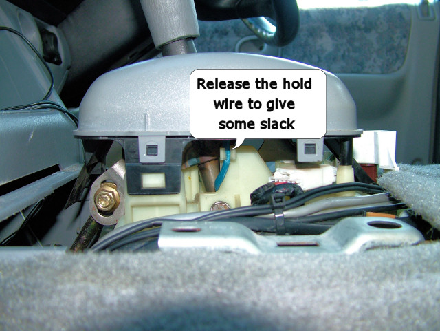

Post by g8dhe » Sun Apr 07, 2019 6:46 pm
I would start by checking the wire that runs up to the the switch on the gear selector, it can be accessed from the passenger side when you have removed the console;

Post by Tony x » Mon Apr 08, 2019 2:39 pm
Hold function is back.
It was the connections to the hold button itself that had come off.
The wire in Geoff's picture goes up to the hold button. You'll see in the picture it goes through a cable retainer which, in my case, wasn't doing its job.
In any case, you remove the centre console, the two screws holding the gear lever on and pull the lever off. The larger top button sprung out for me but will just pull out.
You'll see two black wires with a blue sheath next to the tube from which you pulled the gear lever. Touching these together briefly should light the hold function. If not the problem is elsewhere.
Next, prize the hold button out with a small screwdriver, solder some wires on and sheath. Put the hold button back in (it just pushes in) and connect your new wires to the old ones.
Some jiggling is needed to get the gear lever back in place and the top button just clips in. In the hole where this goes is a white plastic thing. The sloping side must face towards the opening of the hole.
Finally I put zip ties either side of the cable retainer to avoid any excessive tension on where the wire joins the switch.
