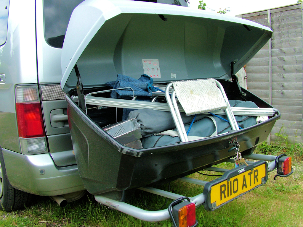

Post by g8dhe » Wed Mar 27, 2019 3:53 pm
Thule do a rugged system;

Post by Bob » Wed Mar 27, 2019 7:33 pm
The 'nose weight' limit, ie the downward force on the tow ball, is 85kgs.
That is evreything, rack, box, and contents. 8)
And bear in mind the total weight a Bongo can carry is only about 500kgs, conversion, occupants, food, water, stuff on rack... :wink:
