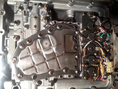

Yes, there is a sensor in the gearbox which prevents it going into 4th until the oil has warmed up see page 41 of the manual here http://www.g8dhe.net/bongo_images/gearbox/RC4AEL.pdf
Its the brown item just right of centre below;
