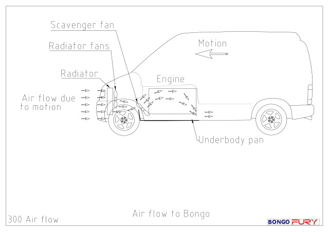

Somebody needs to stop me. I'm polishing the hoses...She just wants to go on holiday in it.
Speaking of which, all the rubber is horrible under there and I broke a plastic elbow at the intake horn. The heat soak is a real problem in this installation and I wonder if the bottom plastic covers make things worse. I saw 3 of these before buying this one and the other 2 were missing the covers.

Post by g8dhe » Wed Jul 11, 2018 1:12 pm
Removing the undertray will badly effect noise and airflow through the engine housing.

Post by TheLongRoad » Wed Jul 11, 2018 2:40 pm
My 2.0 ltr has the under engine cover, thanks for diagram. There was me thinking it was to catch the drips :lol:

Post by Bonneville » Thu Jul 12, 2018 8:48 am
Yes, good picture, thanks. Mine also has a scoop behind the bumper spoiler (Aero model) and another cover behind it. Looks like an attempt at cleaning the airflow up around the big hole where an engine normally sits.
