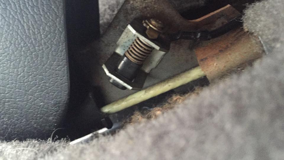

Usual problem with the handbrake switch is the opposite with poor contact as the contacts are exposed and very simply constructed!
The switch is down the passenger side of the handbrake at the rear;

thanks for the pic. do you think i will need to replace it or do you think its ok?

I'd give the contacts a little clean. :wink:

knpenny wrote: Sun Feb 25, 2018 10:20 pm thanks for the pic. do you think i will need to replace it or do you think its ok?
Its unlikely to be broken, so no just inspect what's going on and use a meter to test, its possible something is bridging the contacts rather than actually faulty itself.

Its possible that in tightening up slack in the cable that you've pulled previously unsheathed inner cable into the outer cable, or else otherwise introduced a previously unexercised bit of the handbrake geometry, resulting in slight binding of the cable setup so that it isn't fully/immediately returning to the slack position. I doubt its causing serious handbrake binding but you could check this by jacking up wheel(s) and turning the wheel before and after handbrake applied. This will mean chocking front wheels first (using the supplied chocks in the wheel changing kit) so vehicle can't move whilst jacked with brake off. Whatever, something like wd40 squirted into cable ends (and then maybe 3 in 1 oil or even a suitable grease - but perhaps techies on here can advise if that might not be a good idea with cables) and electrical contact cleaner on the switch should be worth trying. Did you just adjust the cable at the handbrake end? I ask because when i did mine years ago i found i got a good result by first adjusting the star adjusters in each brake drum, then the adjuster on each section underneath the car, then (if still necessary) the adjuster by the handbrake.

Thanks everybody for your replies. it was set between 6 and 7 clicks before adjustment. being a mechanic like you say northern bongolow , i just assumed it was too slack. however, on hills it was not holding too well. have cleaned the contact on electrical side and i think i will give the cable a bit of lube.
also will adjust at the drum with the star adjustment like advised. should be fine with that.
