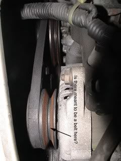

While trying to sort out a battery problem, I found a mangled fan (type) belt close to the alternator. Can some one advise how many belts should be visible under the passenger seat and whether, from this picture, it is clear that I am missing a belt (and if yes, what it does)?
I had a strange noise for a very short time while driving at the end of last year but have not driven more than 4 miles since.

there should be two belts to support the crank, alternator, aircon compressor as can be seen from your missing photo.

I would get it replaced fairly soon, as currently all the load is being taken by one belt, and assuming it is the same age as the lost one, that could go at any time too.

Thanks. Are two required so that one can be a back up or do they also serve different needs as well as the crack, alternator and aircon?

Backup and to share the load. Pretty good idea really.

I would replace them both just to be sure and for peace of mind.Do you know when your cam belt was last replaced :?:

I do not know if the CAM belt has been replaced but have one that will be fitted. However, the mechanic needs details about tensions etc. and I have not found out what they are yet.
Available on a fact sheet in the member's area. Also belts available through the club.

Basic good engineering practice..... Never replace one belt, always the pair (or three or four or... ) as the existing belt will definitely be stretched, so you will never get the tension correct (and probably buxxer up your bearings trying.)
