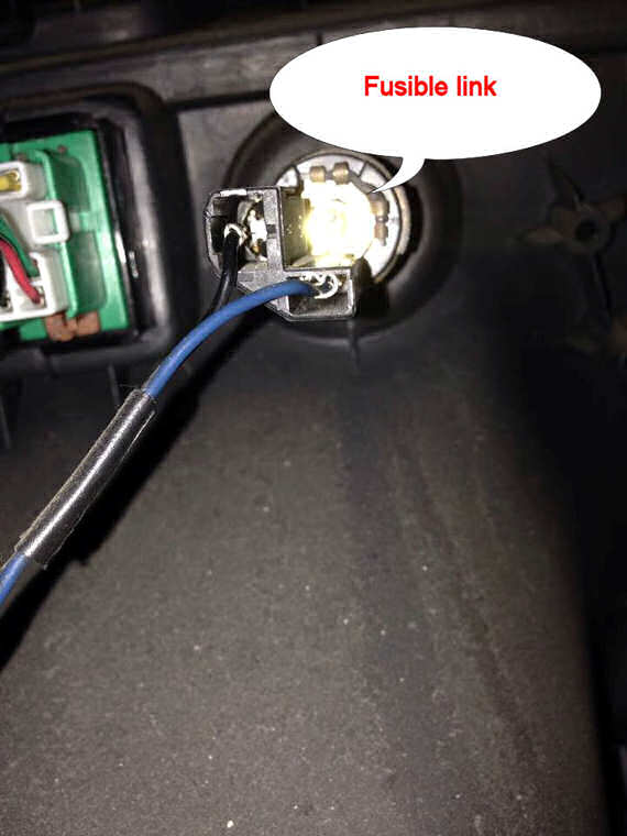

You realise there is a fusible link on the rear of the socket which can be repaired/bypassed ?

I do now. I will need to take some trim off to see better. Mine is not wired with the blue / black wires, i have the black, the blue is in a seperate connector. Also looked at the fused connection and cant see anything wrong with it, what should i look out for ?
https://goo.gl/photos/wkw9TgjYURU9iko96
https://goo.gl/photos/2sr7PrUeoFzYGJx7A

That looks like someone has rewired the supply to the socket, I would trace the wires back and see where its fused and/or what it is connected to!

The wiring has been modified, perhaps to run off the leisure battery instead of the starter battery?
What did you use to check that there is 12v at the terminals?
Use a multimeter to find out where the fault is. They are a very simple device, so should be easy to diagnose and repair.
Test the socket by inserting the positive probe in to the socket so it touches the centre inside (make sure it doesn't touch the sides), touch the negative probe to the outer metal shell of the socket. This should show 12v. If it doesn't then the only thing it can really be is the fusible link on the back. (If the terminals are definitely showing 12v)
Hold the negative probe against the metal side again then use the positive probe to test both ends of the fusible link - you should get 12v at both ends.
Post the results you get on here.

i have a fluke electrical tester from my time on site (years ago) show amp volts and continuity (bell). The rewire from the leisure could be right there is a white fused cable coming from the leisure battery, but it has a purple as well, but the fuse tests ok, i will trace it out and report back.

Just tried with the tester again, red in the centre inside, black on the outside casing, 12v showing on the fluke. tried across both ends of the fused link, no voltage, but if you switch to bell it does sound across the same.

The tester won't show voltage across the fusible link. You need to test between ground and was end of the link.
However your tests have proven that the link is fine and that the socket is providing 12v absolutely fine.
