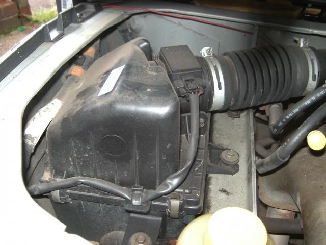

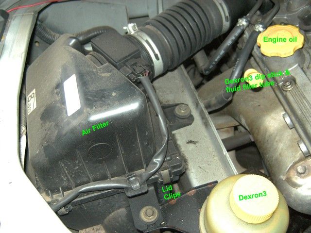

It's under the drivers seat .. An easy DIY job .. the filter lid is held on by steel clips that flick over (sometime easier to flick over with a flat blade screw driver) .. also it is easier to remove if the rear 'air' pipe is removed ..
Re: How to change the Air Filter in V6 Petrol Bongo?
Mike, that's a picture of your Bongo with dust on some engine parts!!!!!!

Sorry that was when I first bought it and before did the first service .. I actually took the complete air filter box and 'air' pipe off and put them in the dishwasher before re fitting ..

Hi, thanks for your swift reply and very helpful (and tidy) photos re the air filter - I reckon I'll be able to tackle replacing it myself now once the new filter arrives - perfect! Many thanks!
