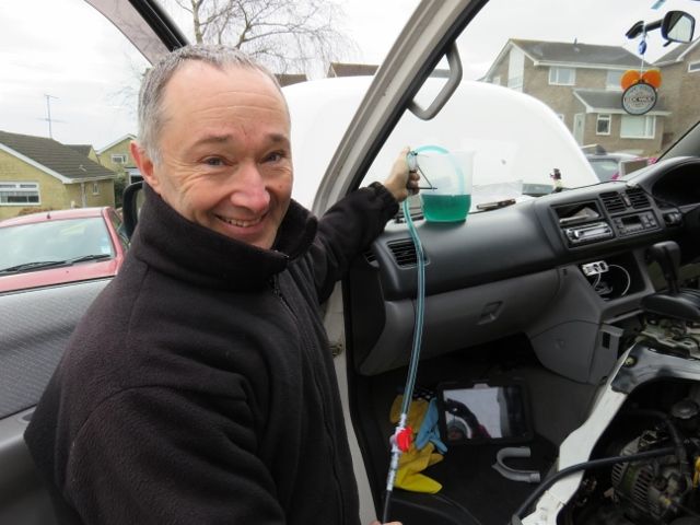

P.S. If a garage quotes elf and safety when they realise they have to play with a funnel of hot water for 45 mins, a jug also works, and a valve makes it more controllable. (All to fit 8mm internal diameter, in case you want to obtain the bits!)
and can bring a smile to the user's face!!
