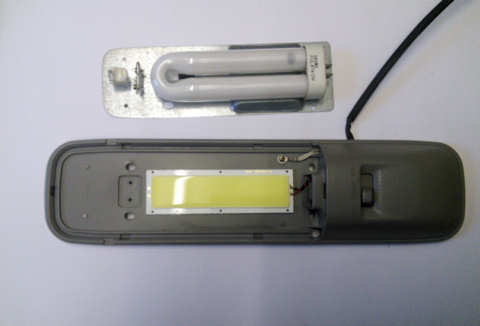

Just got back from a few days in the new forest and the rear flourescent bulb is driving me mad.
So two questions how do I get the cover off to change the bulb and what led can I change it to.

The base has two prise points around the edge to help get the cover off, there are two styles the older straight fluorescent tube and the later "U" type tube, the covers vary as well. If you have the "U" type tube then below applies for changing to LED, click for all the images!;
You can also get replacement LED tubes but they aren't as efficient and availability is limited.

The conversion itself is simple enough using Geoff's guide. The LED COB Panel costs under £2 from HK/China.
I made a further modification to mount it securely and to keep the heat away from the lens:

Mine is the old style single length one, by the time its warmed up I'm on my way home LOL
I have that Cob light already but couldn't work out how to get the cover off so gave up.
Then realised mine wasn't the U type.
Where do I prise the old one off from?
Seen the Vid Thanks!

So will this same style LED panel work for the long (non U shape) light?? Seems I've also seen people use 2 of the 36 LED panel together in the same housing. Anything special that needs to be done there? Thanks!

Yes, but the wiring is a little different, I don't have an old style board to take photo's of so can't show you what needs to be done in as much detail.

If you have the old skool single fluorescent tube type, bung one of these in.

Some don't last long, but the one I have posted above seems to be holding ok. Definite improvement over standard tube, IMO.
If you really want to light up the van, get a 3m strip of leds, run them round the cabin and hook them up to the rear N/S boot light. I have added a 12v dimmer as well, cause the LED's are really bright. :D :D
