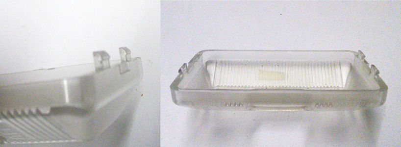

This might seem a bit on the pathetic side of competent but I need to replace the bulb in the light in the back. I have a new bulb and thought you just squeezed the sides of the plastic cover together to get to the bulb but it won't budge. Do I just need to get a grip, man up and show it who's boss or am I doing it all wrong and there's a knack to it?

The clips are here, there are also little screwdriver slots to help remove, but being such short clips they don't give much before breaking ...... as per the one on the left!

Thank you Geoff but I meant the long light in the middle of the roof however I'm sure the principle applies. Here go my lugs!

Yes five clips on the "U" tube version, 1 at the tip, two on the curved section and 2 towards the rear, again screwdriver leverage points are provided!
