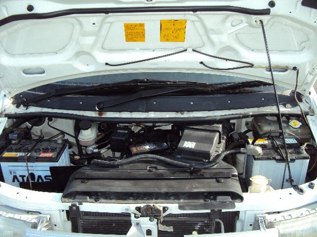

Thank you, I cant seem to do that at the mo. Will have a look later. I was trying to show the two batteries and a yellow label under the bonnet in Japanese and English saying CAUTION!! batteries are connected in parallel . I cant see any evifdence of a split relay although I am by no means experienced. There appear to be 2 main fuse boxes under the bonnet with labels of what they power. They are connected to the SB and power all the normal things. On the other battery it has 2 red wires which seem to travel all the way to the back to power the water pump but another thick covered bunch off wires which travel towards the main battery where it seems to join with a similar bunch of wires from the SB. Could these be connected to the alternator and therefore charging both batteries?? I cannot get the connector off the SB at the mo but can from the LB but the water pump still works?? How can this be. I am so confused.

OK yes that is Northern Japan version, they have very cold winters and hence the starting time can be extra long and the need for two batteries to have enough energy. The batteries are wired in parallel as per the yellow diagram, its difficult to be certain from the photo, but check to make sure that the heavy duty cable coming of the +ve terminal of the battery on the right (nearside) does run directly across to the +ve terminal of the battery on the left (offside), as its often a choice when imported to break into that cable and insert a Split Charge Relay turning the battery on the right into a LB. I can't see it terminating on the lefthand battery because the hand is in the way - so it might have been modified but I can't see!
If it hasn't been modified then any connections to it are just like any other direct connection to the starter battery, a permanent +12 volt supply, you would have to isolate both batteries to stop anything working.
Image below is of a another dual battery version you can see the cable running across the front between the two batteries;
Wiring looms for the relay and patching into the existing fusebox to divert the circuits are available from http://www.solarcampersolutions.co.uk who is also on this forum as Dodgey, currently still on holiday I think in Europe!
