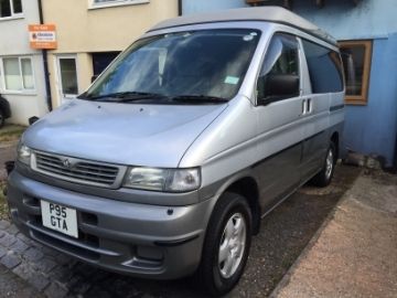

Hi to all me and wife have just got our selves a Bongo and so far love it. we have already turned around the centre seats and will have some cool audio going in soon. my only worry is that the temp sits just over half way. i have keeper an eye on the coolant level and it is at max. the pipes look good and no bulges. it has a ace answers engine temp alarm. but just would like to know if this is the norm. we have been driving around town up and down hills and it just sits at just over half way. looking at all the paper work it has had a full service every year and any probs that have pop up have been sorted (no major probs in paper work and all work has been carried out at Allans Plymouth). can any one put our minds at rest Thanks
it is a 1997 2wd v6
