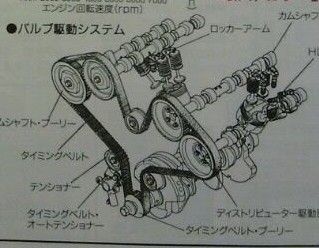

Is it possible to change the water pump on a V6 without removing the cam belt? I'm guessing not, because it probably drives the water pump?

I would not now for sure ,, but with the down ward belt pressure ..... maybe ..??
http://lushprojects.com/bongopartsmk2/c ... 2of02.html

You don't have to remove the cam/timing belt to replace the water pump, the water pump is located in the centre of the gear trail and has its own drive pulley and belt.
