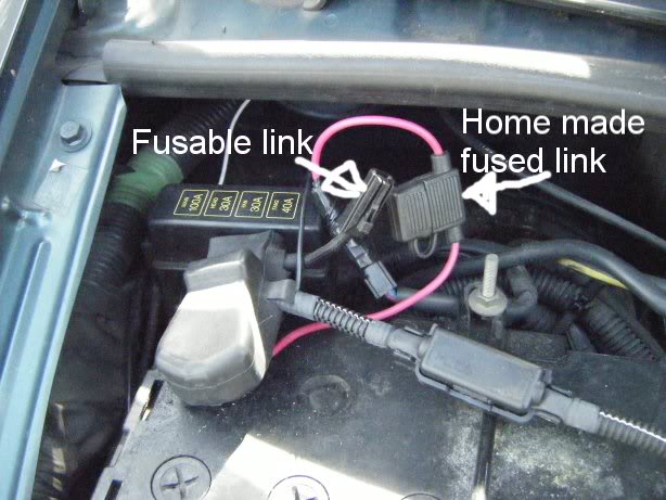

Disconnect the original cable at both ends if possible and replace with the two fused cables feeding into the SPlit Charge Relay.
This is the Starter battery end its the thicker cable coming out from the front - ignore the fusible link annotations!;
