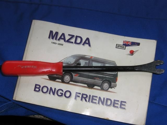

mikeWalsall
Posts: 3075
Re: wheel arch replacement - dilemma
Post by mikeWalsall » Thu Mar 05, 2015 5:32 pm
I use one of these ..

OK - have now bought a trim removal tool.
