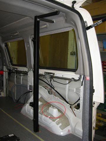

I posted a reply a while back for a similar query for someone who wanted to fit fold up seats in place of bench, but I cant find it right now. You could fit bench seats to a van with fold ups, by fitting the full length runners & probably cutting off the bolts that stick up from the wheelarch to mount the hinge. But the bench seat models do not have theses studs on the wheelarch, so there will be nothing to fix them to. Hopefully, you can see them highlighted here:

That's a hefty piece of steelwork there, Simon!
What's it for? Looks too sturdy for a conversion - do tell !!

Post by chiefster1976 » Thu Jan 18, 2007 8:27 pm
The steel work looks like its basically a mounting point for a 3 point seat belt.....When you do a full side conversion and fit a rock and roll/apex type bed and have a rear wardrobe the old seat belt obviously useless so hence the welded bar...The new seat belt(or use the original you took off) can be attached to this steel frame.....
Look at ava and wellhouse pics and you will see the belt in position directly inline with the steel work!! :wink: :wink:
Not a big job really if you know someone who can fabricate one!!!
You just need to know exactly where the seat belt needs to be...
Hope that helps...GAvin..
